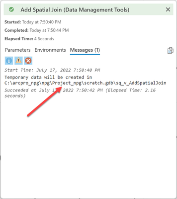

I set a scratch workspace differing from the unset defaults, but it is there and can be persisted if you save it after.

I've noticed this new tool and ESRI seemed to have replaced all mention of the classic Spatial Join tool in the UI with this new Add Spatial Join. Whilst not answering your question, more of an observation, but I have discovered at least one tool that fails with the output of Add Spatial Join and that's the split by attributes tool.
Seems odd that this apparent in-memory join is persisted in the scratch workspace as Dan shows, seems to defeat the purpose of it being in-memory!
