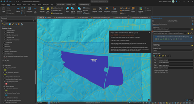

Have run into an error I have never seen before nor have any clue how to resolve at this stage. ModelBuilder is telling me the input dataset I have has spaces in it. As you can see from the screenshot, no it does not.
