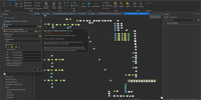

Have run into an error I have never seen before nor have any clue how to resolve at this stage. ModelBuilder is telling me the input dataset I have has spaces in it. As you can see from the screenshot, no it does not.

RyanWalter
I can confirm that there are no spaces in the file path and I had never had this issue before the beginning of March 2025. I have tested this with other rasters saved to C:\Test\nospaces.gdb\rastername
Error still occurs
I have uninstalled and reinstalled ArcPro. Error still occurs. I have updates to the newest version of the software. Error still occurs.
Sometimes, if I open this tool in another ArcPro project, it works just fine - even with filepaths with spaces.
When this problem occurs in ModelBuilder, it also occurs in the Extract by Mask Tool outside of MB. It depends on the day if it wants to behave or not. Incredibly frustrating and I have done everything in my power to fix it - still no luck.

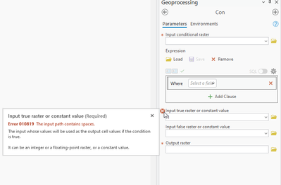

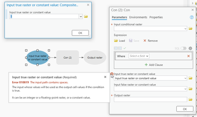

DaveronSmith
As you mentioned, this is a wider issue, not just in modelbuilder, but also in geoprocessing toolbox. Here it is replicated with nothing but the input constant 1 for the Con tool in both modelbuilder and geoprocessing:

KevinMayall
He's not putting a "1" as the start of an output name.  He's putting 1 as a constant value.  How a constant value has spaces in it is beyond me.
