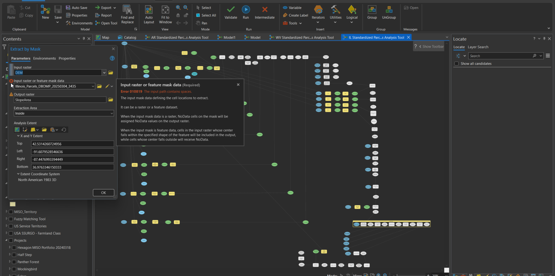

Have run into an error I have never seen before nor have any clue how to resolve at this stage. ModelBuilder is telling me the input dataset I have has spaces in it. As you can see from the screenshot, no it does not.
I have tried to:
  1. Restart Arc
  2. Save the model as a new version
  3. Write the input file to a folder and geodatabase path with no spaces anywhere present
  4. Change the name of the input dataset on a re-export to a singular word
  5. Restart my computer
  6. Uninstall and reinstall ArcPro
All to no avail. Would love guidance, been doing this for 8 years and never seen something like this happen.
