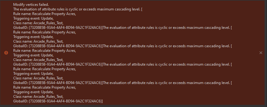

I am trying to create an attribute rule that updates the GIS_PropertyAcres field across all features that all share a common Parent Property ID when the geometry of a feature is updated. I am constantly getting a  Does anyone know how to modify the following code to prevent this error from occurring?

When you return a dictionary with update instructions, these updates trigger the rule again. You have it set up so that the same feature gets updated over and over and over, so at some point ArcGIS halts the loop and errors out.
I think you have the right idea in line 11: You need to check whether the attribute you care about was changed by the update. If not, you don't need to return further update instructions. I'm not really sure why your condition isn't working, and I honestly don't feel like diving too deep into it...
Anyway, here is an expression that should work as expected. It updates both GIS_TractAcres and GIS_PropertyAcres, so you only need this one rule. It also handles deleting features properly.
