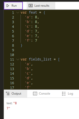

And here it is run against a made up feature:

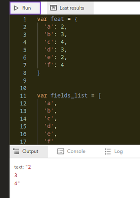

And if I make it so multiple values tie, I get all of the modes:
