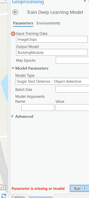

I use ArcGIS Pro. I tray to learn how to apply deep learning tool. When I reached the training model step, I've got the following message:

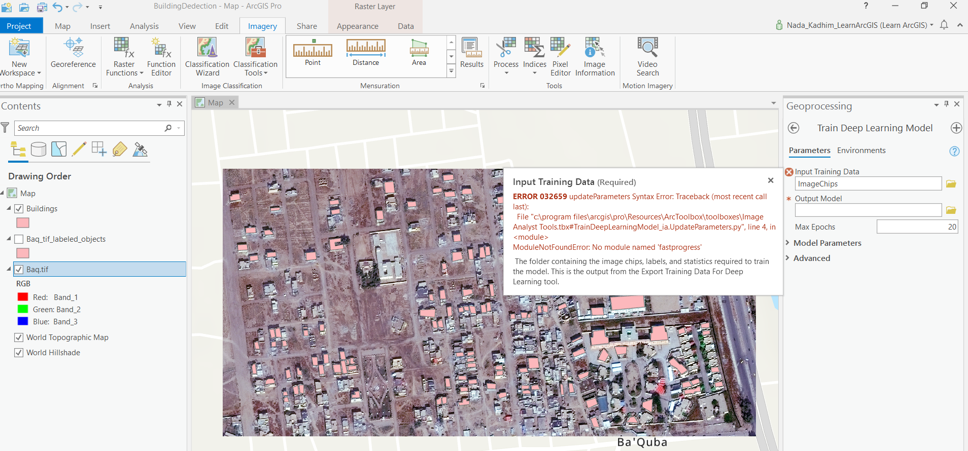

ERROR 032659 updateParameters Syntax Error: Traceback (most recent call last):
  File "c:\program files\arcgis\pro\Resources\ArcToolbox\toolboxes\Image Analyst Tools.tbx#TrainDeepLearningModel_ia.UpdateParameters.py", line 4, in <module>
ModuleNotFoundError: No module named 'fastprogress'
Please, I need your help.
All steps before training the model were fine but when I just input the imagechips folder the tool gives me this message. How can I avoid or solve this problem because when I hit the run button another message displays: “parameter is missing or invalid”.

Dr. Kadhim - this appears to be BUG that should be fixed in the next release of ArcGIS Pro 2.6.  For the time being, this is the workaround.
BUG-000129130: The Train Deep Learning Model tool does not recognize the output of the Export Training Data For Deep Learning tool.
Please try this workaround and let me know if it is helpful.
  1. For the Export Training Data For Deep Learning tool, under Meta Data Format, choose any format other than KITTI Labels, such as PASCAL Visual Object Classes.
  2. Open the Train Deep Learning Model tool.
  3. For the Input Training Data parameter, select the output of the Export Training Data For Deep Learning tool.
