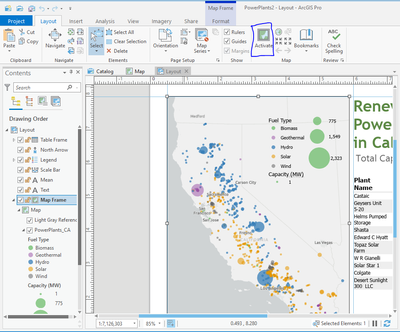

Hello,
If you select the map frame on the layout and choose Activate (see image below), the properties of the map become available in the layout view. So the time slider will become visible and you can make adjustments. Then you can close the activated map frame and continue working on your layout. I hope this helps! You can learn more about working with activated map frames here: https://pro.arcgis.com/en/pro-app/latest/help/layouts/work-with-a-map-on-a-layout.htm
Cheers,
Aubri
Cheers,
Aubri

AvivitLevy
Yes! thank you very much Aubri
