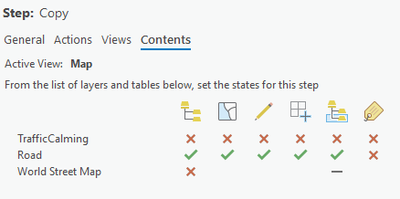

I'm also getting that same error. (Found 1 error(s).
Error : Cannot run command assigned to the step. It is not enabled.) Ive been troubleshooting for quite some time. I read in an older post that it might be a bug? Anyone have a solution?  Ive tried disabling all options on the layers that I dont want to copy from.  (ArcGIS Pro Desktop 3.0)
Workflow
Select a road
Copy that selected road
Paste Special into another feature class named traffic calming
Merge the road to the selected feature in traffic calming.
Running this workflow manually works fine but Tasks seems to not like it.
