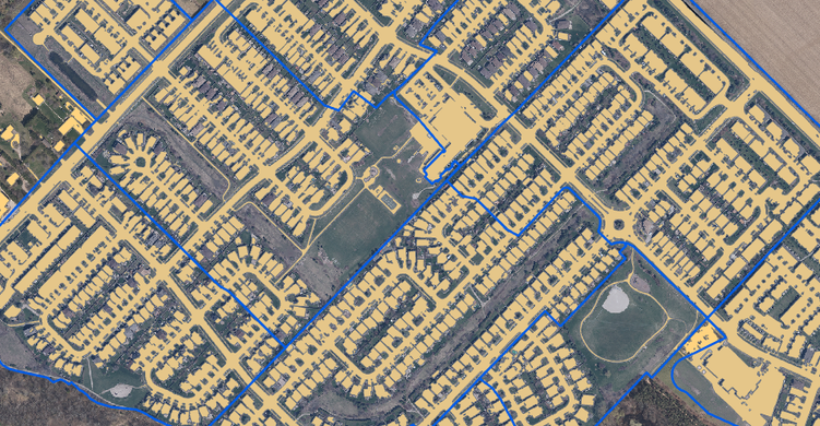

Could you provide some screenshots of the input layers, too? I wonder if perhaps the intersection is counting a row for every piece that intersects, as opposed to every input feature. You could intersect two features and end up with nearly infinite singlepart geometries if the input geometries were complex enough.

Thanks for the response. I have posted a screenshot of my data below. I am trying to calculate the percentage of impervious land cover in each stormwater pond catchment. I have 1 zone field which is the ID of the catchment, and no class fields. I will try to run it on a small subset and let you know the outcome.

Well, this is certainly curious. Are those impervious features all just one big merged feature?

Well there are 88,000 features, but the vast majority of the area comes from 1 feature that includes the roads and everything connected to them. Do you think it would run faster if I merged it into 1 big feature? I don't think it would be possible to break this feature up as I merged and dissolved it with a few other layers to fill in gaps and the roads were probably all connected in the raw classification results anyways.
