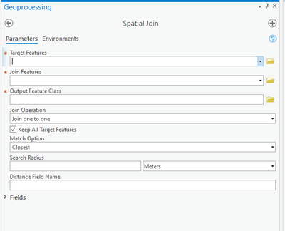

@Anne-LaureZufferey im assuming your table has lat/lon or XY coordinates from which to generate either a point feature class or XY event layer? If so, you can then think about how you want to assign the attirbute data to the polyline. Im assuming each segment of polyline has an associated point that it's closest to, and you want to assign the values from the point to the segment?
In which case, Spatial Join can be used to join based on closest point to each feature
