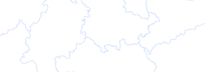

Buffer* around lines:

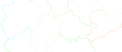

Color Theorem on Buffer:
Spatial Join (largest overlap)
This last step may need some trial and error to achieve best results for your use case.
Results may vary based on the Match Option,...*
