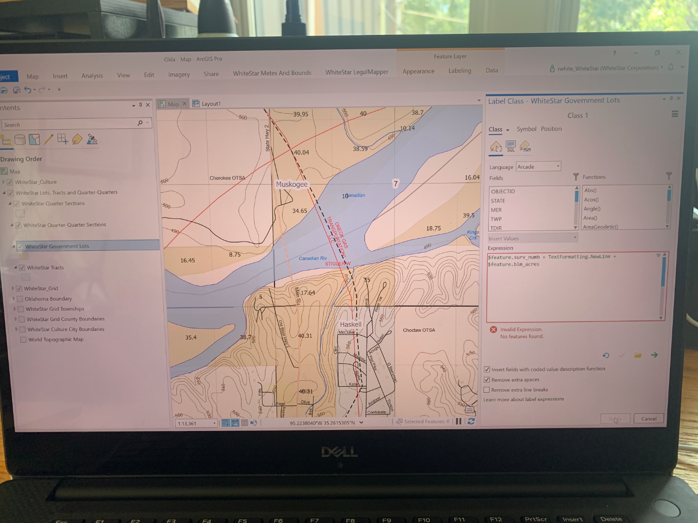

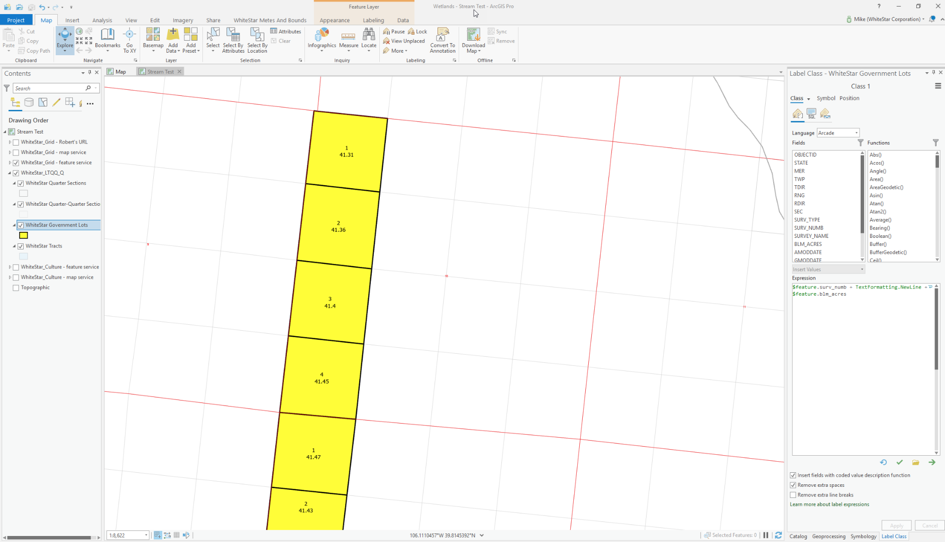

When trying to perform a simple label expression on a feature service, my colleague and I have different experiences.  I'm using ArcGIS Pro 2.5.1 and my expression labels correctly (Image 1).  My colleague is using ArcGIS Pro 2.5.2 and his expression fails stating 'Invalid Expression.  No features found.' (Image 2)
We've tried both Arcade and Python.
Image 1.  Correct behavior in ArcGIS Pro 2.5.1:
Image 2.  Incorrect behavior in ArcGIS Pro 2.5.2:

I was getting this same error, 'Invalid Expression.  No features found.' Then I checked the SQL tab within the Labeling pane and realized I had an old query still set to filter data. Once I cleared that, the label expression validated and the labels appeared 🙂
