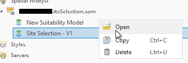

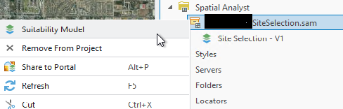

1) Open a Pro project that holds a .sam file/layer.
2) Click on Suitability Model from context window of .sam file in Catalog -or- open model
-or-
3) See missing information. A model that previously held raster criteria is empty.
