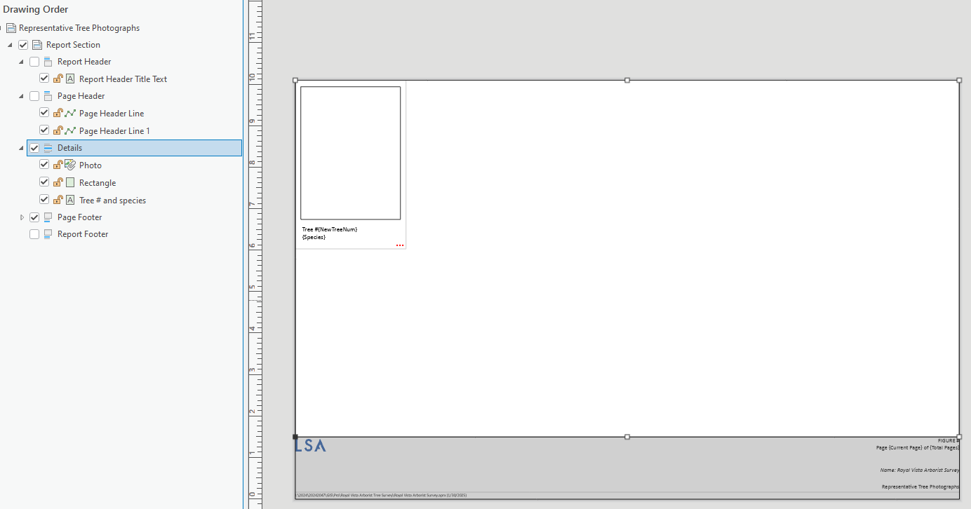

My initial attempt resulted in the same point/photo being duplicated 12 times on each page, with each page displaying a new point (12 times). From that, I have deduced that each "Details" section can only display attributes and attachments for a single feature per page. Assuming that's right, what I now want to do is duplicate the Details section 12 times on each page, with each Details section showing details for a new point, but I can't figure out how to do that. I don't see a way to duplicate, copy/paste, or insert a new Details section.
Am I on the wrong track? Can anyone point me in the right direction?

Thank you for the response! I think I understand what you're proposing, but I'm confused on one point. You are doing this as a layout, not a report? Or are you using Reports? I'm guessing you're using reports, in which case I could probably make one with two rows (one photo + caption in each row) and a width of 1/6 my landscape page width, and then use Acrobat Pro or InDesign, import six of these to each page, lined up left to right across the page. I've never done that last part, but our Graphics crew could probably handle that part. Thank you for the suggestion!

I've never actually worked much with Reports, personally, but a glance at your second screenshot suggests the workflow would likely be similar.
