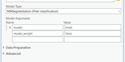

I apologize for the oversight. The Prithvi backbone in DeepLab has been incorporated for ArcGIS Pro 3.4 which will be released in Oct - Nov. For Pro 3.3, you can train the HRNet model using MMSegmentation. Please refer to the screenshot below.
Regarding the 4th point:
"I haven’t yet tested your suggestion of using tile sizes of 400 x 400 or 512 x 512. When I use 256 x 256 pixels, the output mainly shows one class, which I suspect is related to my input training polygons, none of which exceed 1 km in width. However, when I reduce the tile size to 32 x 32, the outputs seem more viable. Should I adjust my tile size to ensure I capture 'pure' training samples? My experiments with 32 x 32 tiles suggest that this might be the case. What are your thoughts?"
While pure pixels are indeed crucial for remote sensing traditional classification approaches, deep learning models benefit from larger chips that encompass multiple classes to better learn distinctions between them. Given that we’re working with Landsat data at a 30 m resolution, larger tile sizes—like 400px x 400px, 448px x 448px, or 512px x 512px—will provide the model with better context for recognizing various land use/land cover classes. Using 32px x 32px tiles may hinder the model's learning and lead to misclassification, as it lacks exposure to multi-class in single image during training.
