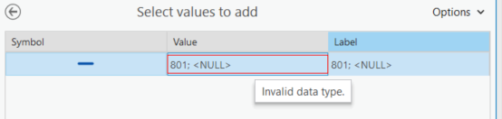

Yet when I try to do this via the "add values" option in the symbology pane I always get an error:
I tried several different options of null, " ", , Null, <Null> but nothing works
The field from the <Null> is a numeric long integer field. How can I add this to the list??

I mainly to know why it does get taken into account when it's in the attribute table but when the combination is not and you want to add it you get a warning that this value is not allowed.
