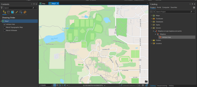

Here is the basemap I'm trying to add to ArcGIS Pro. --> The Mapbox map is the correct version when viewing in a browser window - but not when I add it to ArcGIS Pro.
In ArcGIS Pro, this is what it looks like:
It's almost like ArcGIS Pro ignores the changes, and just pulls the default from the Mapbox server. Not sure of a good way to explain it.
Just curious if anyone has been able to use an updated Mapbox map in ArcGIS Pro! I have the latest version of Pro.

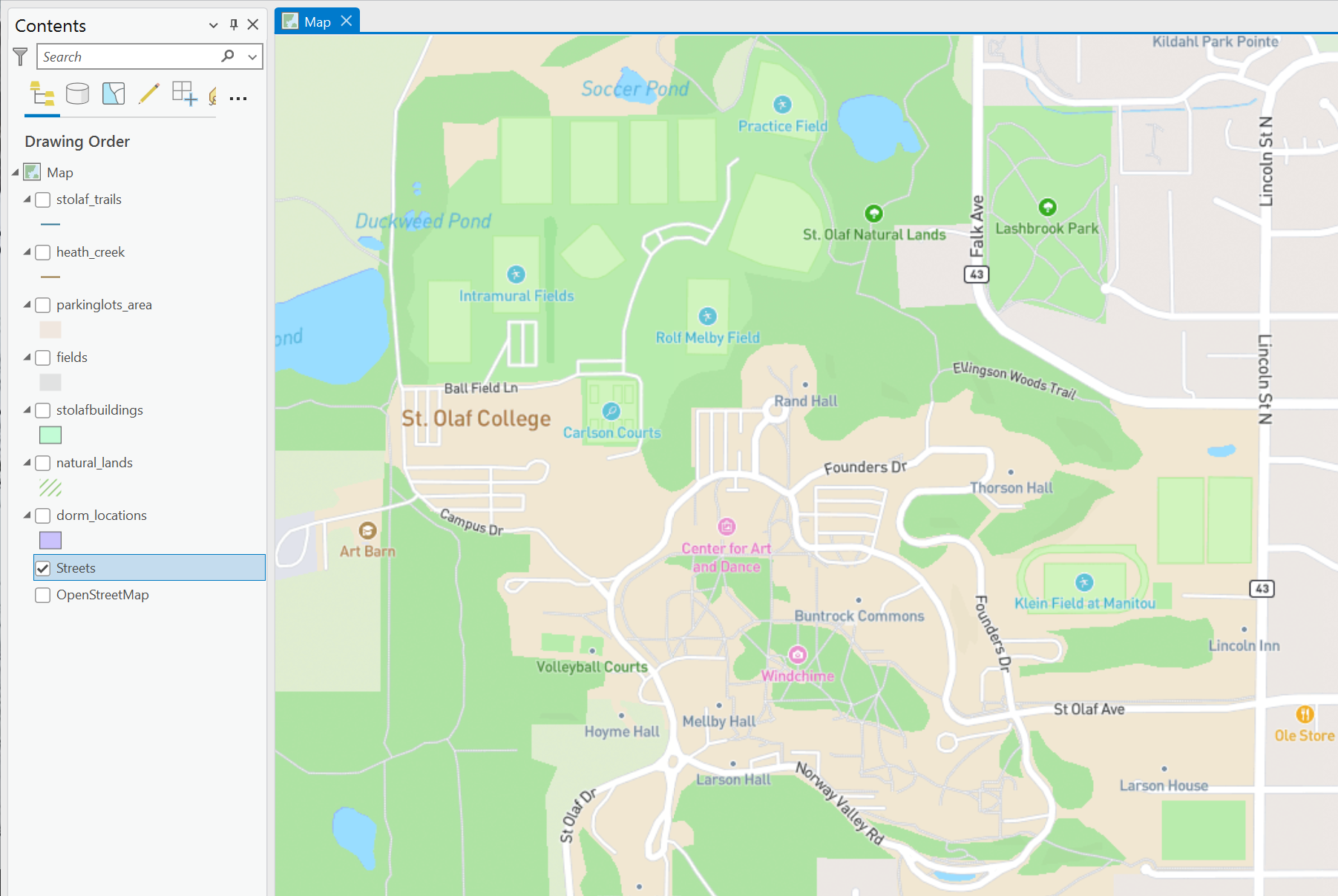

Hi @SaraJL
How were you adding the WMTS to ArcGIS Pro, and what URL were you using?
I'm new to Mapbox but following this guide (https://docs.mapbox.com/help/tutorials/mapbox-arcgis-qgis) I constructed this WMTS endpoint for your map: https://api.mapbox.com/styles/v1/dale1/cli1rbeys00ml01pjbtjg48ik/wmts?access_token=pk.eyJ1IjoiZGFsZT...
When I add this to ArcGIS Pro (Insert > Connections > Server > New WMTS Server) it looks pretty close.
Mapbox:
ArcGIS Pro:
Is this helpful?
