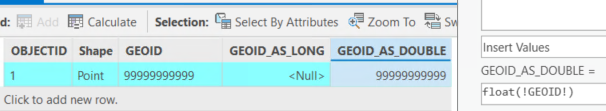

Are you converting a text field to a long integer field? The maximum value of a long field is (2^31)-1, or 2,147,483,647, which is 9 consistent decimal digits, or 10 in some cases. To store numeric versions of larger numbers, use a "double" field, that gives you 15 consistent decimal digits with no precision loss. Here's a quick field calculator example (the long field is null because the value causes the calculation to fail due to size restrictions):
