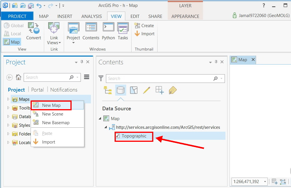

I couldn’t figure out if there is a way to stop adding the “topographic” service each time a new map is created.
How to ban the automatic adding of the “topographic” service?

Please, have a look on how I started my project\map. In this scenario, as the map is created, the “topographic” service is automatically added.
I’m not sure if there is a setting that bans the “topographic” service to be added by default to the created map.
