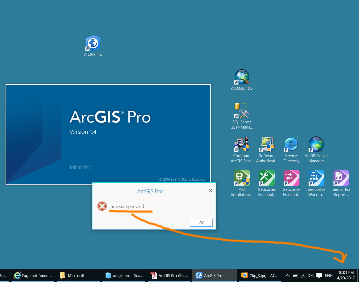

Starting ArcGIS Pro ends up with “timestamp” error,
I couldn’t figure out why the ArcGIS Pro fails to start and shows timestamp” error.
What might be the issue here?
Thank you

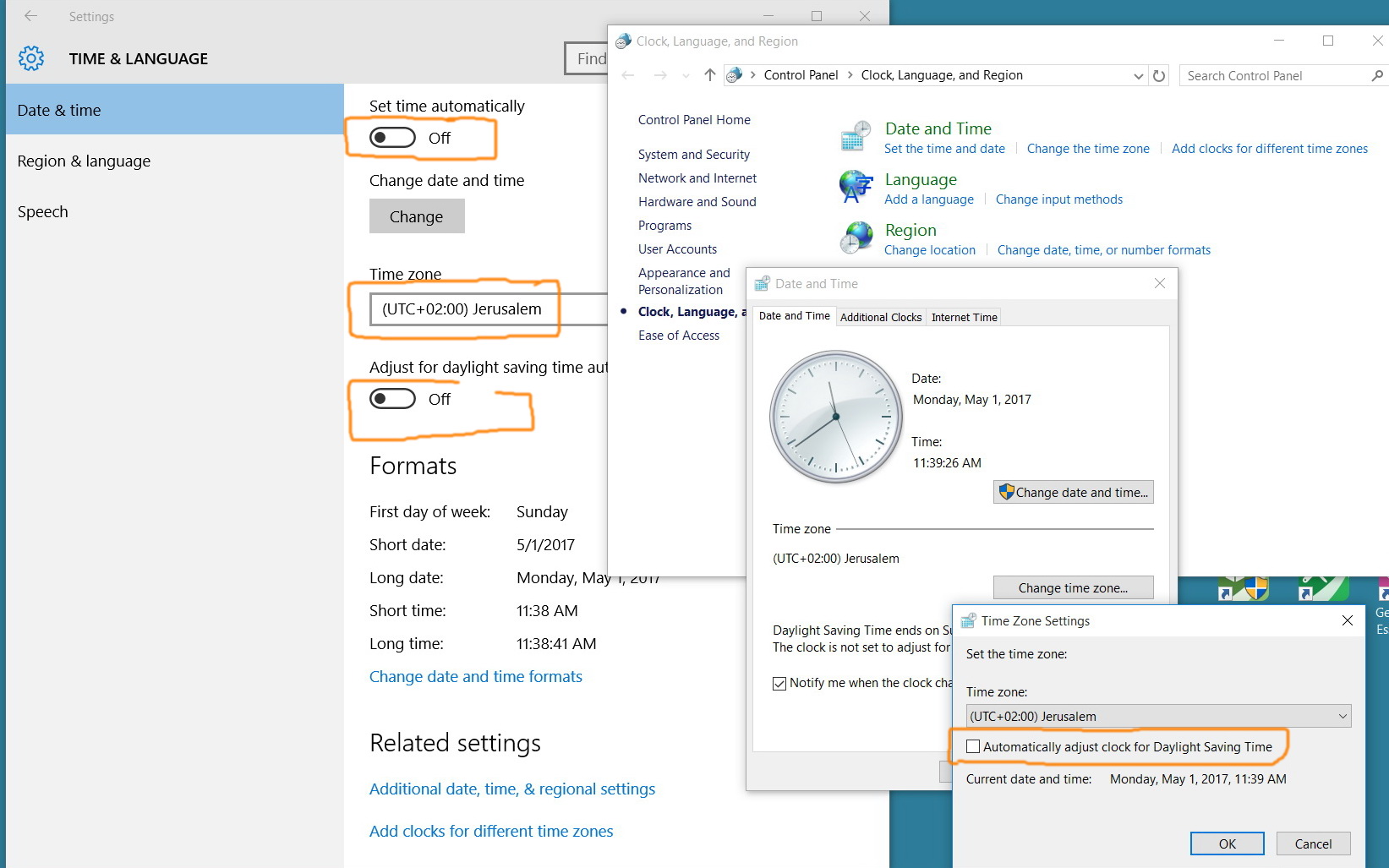

did it ever work? is there a time difference between your ArcGIS online and your locale?
JayantaPoddar
MVP Alum
Also make sure the time-zone set in your local machine is correct, and the internet time is in sync with the system time.

Thanks Dan and Jayanta.
It appears to work fine with the windows settings below
Jamal Numan
DanPatterson_Retired
MVP Emeritus
that makes sense, there was a time difference since Pro is tied into your account
