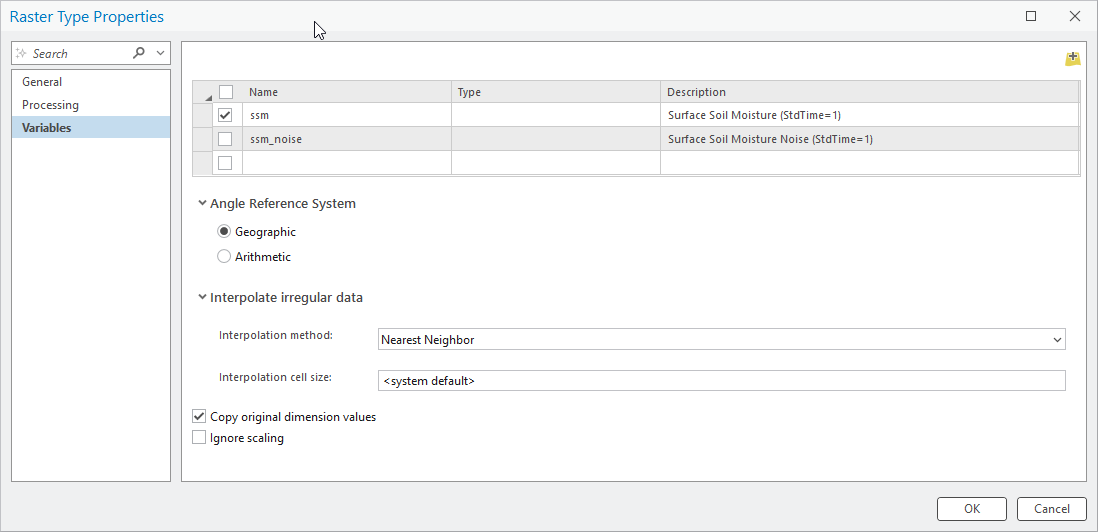

6. To make a multidimensional mosaic dataset from a collection of NetCDF files I followed these steps:
  1. Make a new Geodatabase and a new Mosaic Dataset.
06_GDB-MosaicDataset.png.
      2. Right-click the mosaic dataset > add rasters.
       3. Run.
7. The multidimensional mosaic dataset is created and functions normally.
