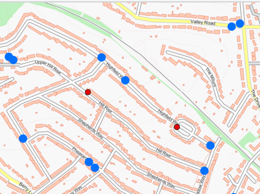

  • Location accuracy varies points may not align precisely with assets, leading to spatial scatter. See screenshot below.
Spoiler
Methods Used – Image below.

Method 2: Python-Based Temporal Filter (Red Points)
  1. Same initial cleaning and clipping steps.
  2. Performed a spatial join.
  3. Used a Python script to identify repeated enquiries:
    • Matching Easting, Northing, and Subject Name
    • Logged more than 1 year apart
This method captured some cases missed by Method 1 but also failed to group certain most overlapping points.
Visual Comparison
As shown in the image below, red points (Method 2) and blue points (Method 1) don’t always overlap. Each method captures different aspects of the problem, and neither is fully comprehensive.
Next Steps
Looking for recommendations for improvements and next steps, I could append the 2 datasets and remove the intersecting points but want to look at mistakes I have made or alternative approaches which could highlight repeated enquires I am missing.
