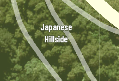

We have a map, currently sitting on a server we are migrated to our new Enterprise environment. It was orginally published using ArcMap 10.5.1 you can see the resulting map here TSB Festival of Lights . Note the label for "Japanese Hillside" next to Fountain Lake.
Image showing ArcMap

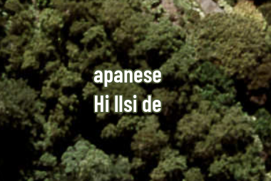

However, it appears in ArcGIS Pro that using "Barlow Condensed" fonts the labels that have 'J' (or 'j' in them, create unexpected results.
They either rotate (if no stacking is applied) or if stacked, cause the J to disappear and for spaces to appear.
I can confirm that spelling the word with a different letter fixes the issue.. however I need to spell Japanese with a J!

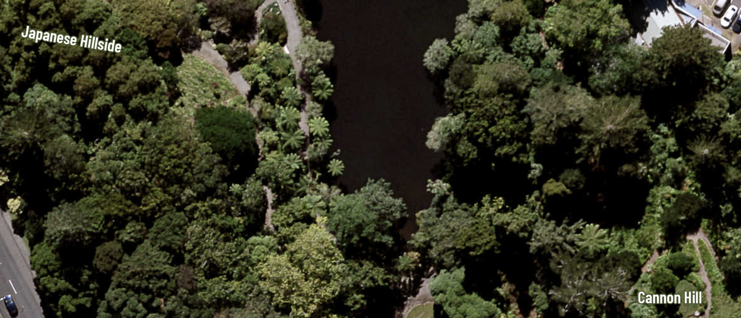

Image showing ArcGIS Pro with stacking enabled
Image showing ArcGIS Pro without stacking enabled
the extent shows another nearby label in the same layer to illustrate that the Japanese Hillside layer should not be rotated .. no rotation settings are set, but my label rotates none-the-less.
