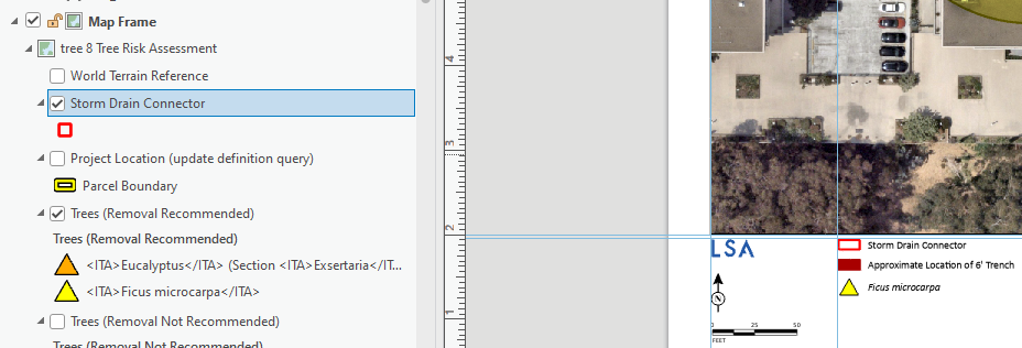

Does anyone know how to get the square patch shape to show up in the legend without throwing the legend alignment out of whack? What I want is a square patch for my first legend item, with all patches horizontally center aligned and all labels horizontally left aligned.

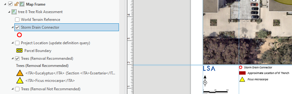

If I change my polygon patch shape to a circle, it is reflected in both my TOC and my legend:

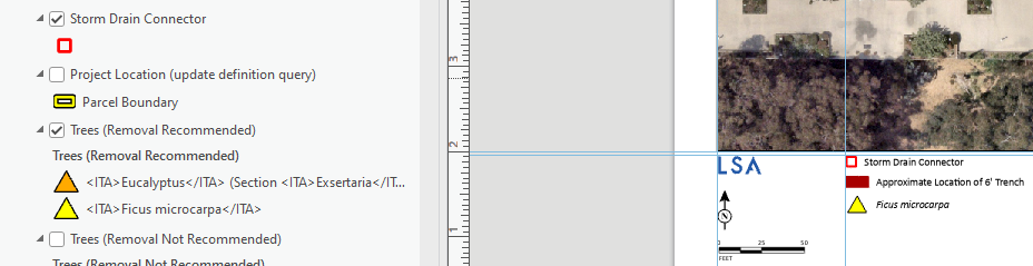

However, if I change my polygon patch shape to a square, it is reflected in my TOC but NOT in my legend:

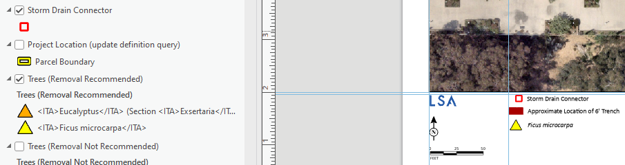

If I adjust the patch width to force it to be a square, it knocks my legend out of alignment because I can't center align patches while maintaining left-aligned labels.
If I add spacing before the legend item to push the align the text, then I'm not happy with the patch alignment.

I think the easiest thing to do would be to include a dummy point layer for the legend.
