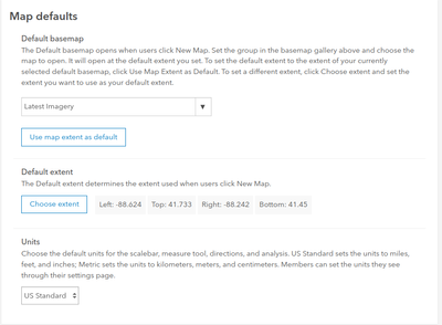

Those settings come from the Portal that Pro is connected to. If you go to the home/organization.html?tab=map#settings page of your portal, you can set the default basemap, extent, and units.
Individual users can override this default in their application settings, but the default setting is to defer to whatever you set here.

Yes and just to add to the above answer
Map and scene options—Properties of maps | ArcGIS Desktop
Organization > Settings > Map > Default Extent.
