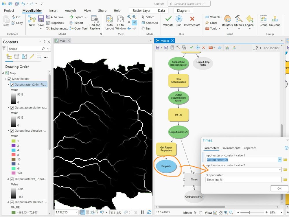

I am unable to figure out how to insert "cell size" as a constant in the "times" tool within model builder.

I can replicate the same issue.
It's not ideal but as workaround could you add the "Create constant raster tool", use the raster properties as the cell value and then feed the output raster from that into the tool as "raster 2"
