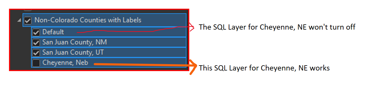

I have been working on creating a state map with our  forest. This is to show our customer who comes into our office and our front Desk employees can show them where or which forest. The map I have has a layer that show all the county names and their symbol too.  I was able to turn two of them off :however, one of them will not allow me to turn it off . I had to create a new label class for that county because it will not display in the map layout.

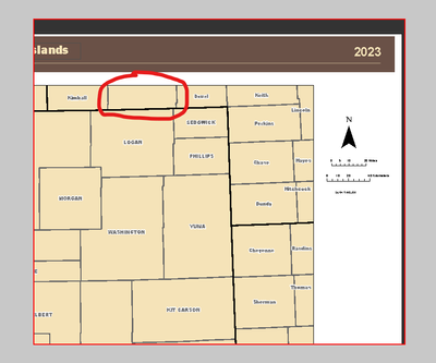

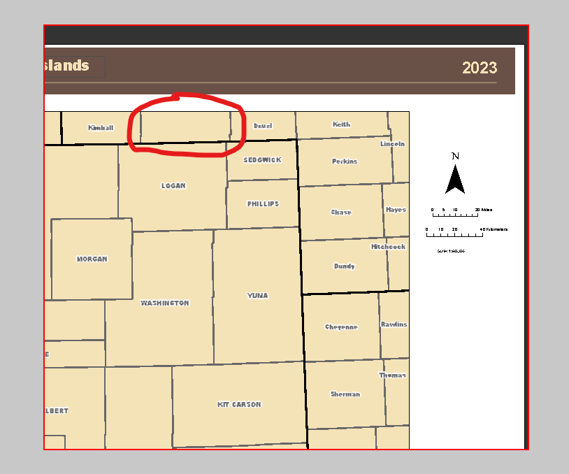

Example in the Map Layout :
This circle shows the county label is missing and It is shown in hidden outside of the map t. It is located in Cheyenne, Nebraska. When I create a new label class for that Cheyenne, NE and it will show up correctly in the map layout.
However, the default label class I wrote will not allow me to turn Cheyenne label off . It keeps showing up and display.
( OR)

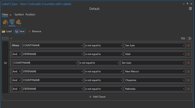

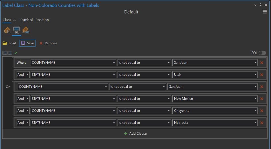

The list I create for Label classes as follows :
Would anyone in here help me out how to get it the label "Cheyenne" to turn it off in this  Default label class ?
I believe this SQL requires me to have two conditons for one layer ; but what if you have at least two and I think it will not work for this situtation.

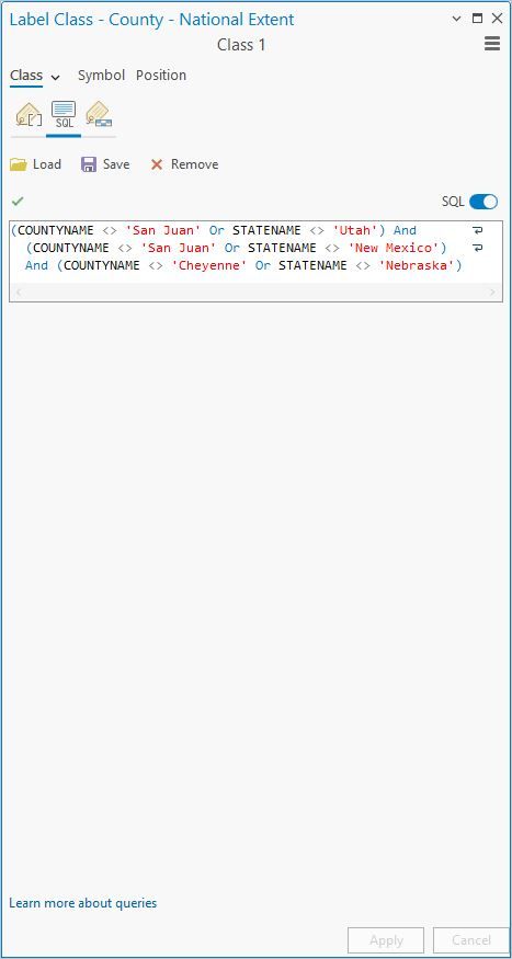

Problem solved.  I could not figure it out until this morning and decided to try different methods ; however this is the only way it works..

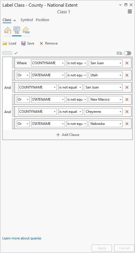

So if the goal is to not display Cheyenne County labels, this would work.  I think the issue is parentheses and the use of and/or's. See below.
