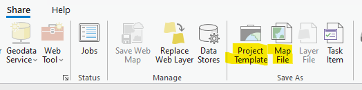

I'm looking for the best way to set up Pro map templates for use by coworkers who have some GIS skills, but are not everyday GIS users.
Currently, we use .mxd files that are set as read-only on our server, and this method works well. The user opens the .mxd, the user can add or subtract map layers from our enterprise SDE geodatabase or from their own project-specific files, and then the user can save the map to another location on the server.
The project-based setup of Pro presents some challenges to creating a similar process.
From testing out different methods, it seems that either of these methods are the best options:
  • Create a Project Template (.aptx) that users can unpack and save to their own location
  • Create a Layout File (.mapx) that users can import into a Pro project started in their own location
Can anyone share thoughts on the pros and cons of using these options in practice?
I am also worried about cases where a user wants to re-name their project or move it to a different server location. Anyone have tips or experience to share on this?
jmaxwell_braun
Templates include style files, geoprocessing tools, and other things in addition to the layouts and maps. Layout files only include the layout and map, no 'extras'. That can be a big downside if you want to use a consistent style file. For that reason, we usually use template files.
One approach is to make a very basic template solely for the purpose of including those 'extras' (no layouts or maps), then have layout files that are imported for each project. That way you still get the style files and other extras, but don't have to have a bunch of different templates to maintain. We have run into confusion before because we have template files containing layouts and separate layout files. If updates are needed, you have to remember to update the template files AND the layout files.
As for your second question, creating a new project using a template file will ask where to create the project. As long as the user tells it the right place you should be good. I don't know of any way to prevent someone from renaming or moving a project after it's created.
