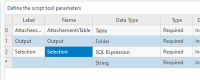

I would like to find out how to download selected attachments.
I have used the script below and followed instructions to create a script in Pro and download the attachments to a specific folder. What I would like to do is add an SQL query so I can specify the attachments I want to download.
I set up the script tool to use  SQL query  and specified the name of the column
However the query has no values.

SQL Expression parameters require a "Dependency" on the parameter you want to filter so it can populate the dialog, set that up and your parameter should work

thanks do you have an example that I could add to the script
