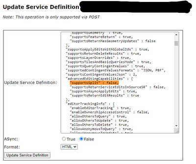

Looking into this issue, could anyone confirm what this setting in the ArcOnline JSON editor might be? I can't find anything through the Googs.
We know the layer already supports splitting, and I'm unaware of how/where these settings are relevant.

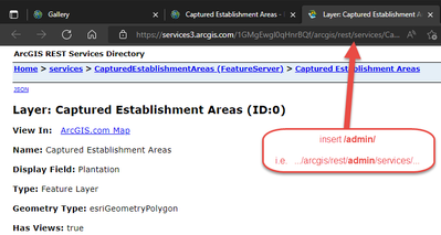

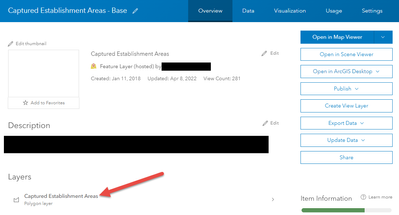

1. Go to item page > click on sub-layer > open Service URL
2. Modify the URL to see the Admin settings
3. Scroll to the bottom of the page and select the "Update Definition" option

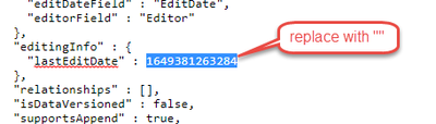

4. Clear the lastEditDate value (replace the value with "")

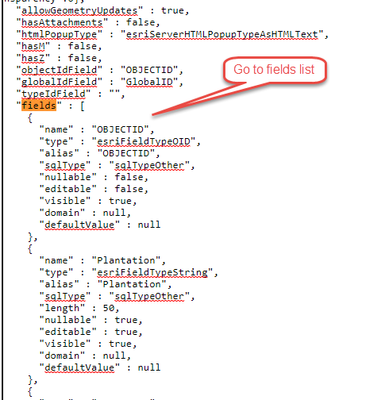

5. Scroll down to the fields list
6. Update any field domains where domain is NOT null with the below line of text:
        "splitPolicy" : "esriSPTDuplicate",

7. Click the "Update Layer Definition" button and whalla! Your features should now duplicate attributes in fields with coded domain values when split in ArcGIS Pro 2.9+

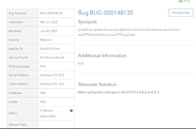

I appreciate your very detailed explanation of how the the REST API should be able to be used to correct the issue with the Split policy. Here is the latest information on the Bug BUG-000148135 related to this.
I think the severity should be higher than medium since the workaround given is impractical.
Anytime you re-publish from ArcGIS Pro you need to be aware of side effects like losing pop-up definitions and symbology and other impacts to your maps and dashboards in AGOL. I think esri underestimates this effort and thus set the severity to Medium.
