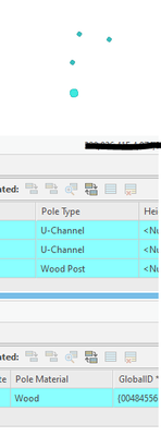

SarahHartholt
I am working on a similar project. I have more research to do regarding the near tool, but wondering if it may be possible to use a combination of the near tool and an attribute query to ensure that the correct pole is selected based on a similar field (Pole Type/Pole Material).
In my example, I have 1 street light and 3 poles in close proximity. I want to ensure that the attributes from the street light feature class with a Material Type field of Wood are transferred to the pole with the Pole Type of Wood Post.
