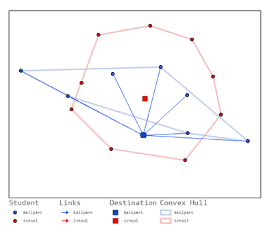

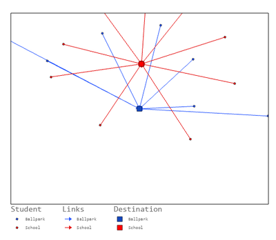

So, I made some points and pointed them at each other. My students are going to either the school or the ballpark.
Then I apply a page query to the links.
and I'm still only seeing part of my students and my links.

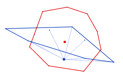

Here's a solution:

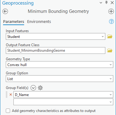

Use Minimum Bounding Geometry with a convex hull on your students

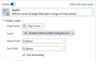

Then use that as your index layer.
Your index layer does not need to be turned on for the spatial map series to work. Also, make sure that your extent is not locked the way mine was-- it was "center and maintain scale" and that wasn't helpful.
