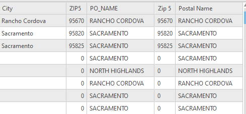

Is there a bug regarding the spatial join in ArcPRO?  We tried to join a table of addresses with a table of zip codes. Below Zip 5 should have zip codes, instead it has zeros just like the ZIP5 column. Has anyone had this happen before? I tried it in Enterprise and it worked using the two same data sets. Very strange. Thank you for any input. Annette

No, spatial join was used.  We have points and then the polygon is the zip code shape file.
