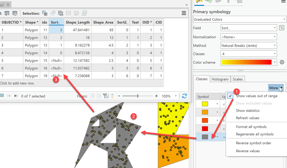

I used the spatial join tool to combine point features with polygons features. It worked out for me but the problem is I have more polygons than points so in the attribute table some fields are filled with <NULL>. These fields are missing completely and instead there are gaps in the map. How can I dispaly just empty polygons on the map?  Thx in advance!

Hello Barry,
It looks like your symbology is not including the "Null" values.  Try resymbolizing to include all "other" values.
Amanda Bishop, GISP
DanPatterson
MVP Esteemed Contributor
Show values out of range In Pro 2.9 at least

Hello Barry,
Amanda Bishop, GISP
DanPatterson
