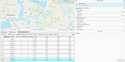

I just ran a quick test on very simple  test data.  I used my simulated wetland "TestPoly1" as the Target FC and "Testpoly2" as the join layer.  I used one-to-many and checked "Keep all Target Features".  My result was what you want I believe....the table reflects one row for each (simulated) wetland polygon/join polygon combination.  Hope this helps.
