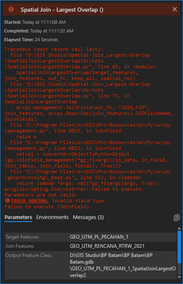

AlfiyanMustaqim
Maybe I have the same case
File "D:\GIS Studio\Spatial-Join_Largest-Overlap\SpatialJoinLargestOverlap\Scripts\SpatialJoinLargestOverlap.py", line 85, in <module>
SpatialJoinLargestOverlap(target_features, join_features, out_fc, keep_all, spatial_rel)
File "D:\GIS Studio\Spatial-Join_Largest-Overlap\SpatialJoinLargestOverlap\Scripts\SpatialJoinLargestOverlap.py", line 73, in SpatialJoinLargestOverlap
arcpy.management.JoinField(out_fc, "JOIN_FID", join_features, arcpy.Describe(join_features).OIDFieldName, joinfields)
File "C:\Program Files\ArcGIS\Pro\Resources\ArcPy\arcpy\management.py", line 8015, in JoinField
raise e
File "C:\Program Files\ArcGIS\Pro\Resources\ArcPy\arcpy\management.py", line 8012, in JoinField
retval = convertArcObjectToPythonObject(gp.JoinField_management(*gp_fixargs((in_data, in_field, join_table, join_field, fields), True)))
File "C:\Program Files\ArcGIS\Pro\Resources\ArcPy\arcpy\geoprocessing\_base.py", line 512, in <lambda>
return lambda *args: val(*gp_fixargs(args, True))
arcgisscripting.ExecuteError: Failed to execute. Parameters are not valid.
ERROR 000308: Invalid field type
Failed to execute (JoinField).
I used 106.000 records
