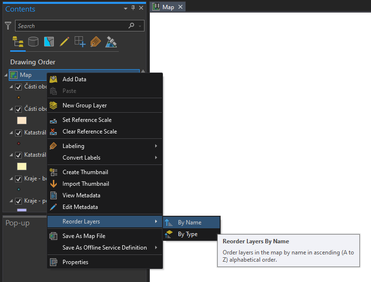

Hello dear @TheodoreF @Gianna_BBSRC @JakeSkinner @AlderMaps ,
looks like there is new feature in Pro 2.7.2. I believe this is the goal 👍

DavidNovak
SWATConsultingInc
Thanks for this tip, this worked great!
I'm curious, do you know if there's a way to do a sort on a specific group of layers as opposed to applying the sort at the main map frame level? For example, you have one group of Wildlife Sensitivity layers and only want to sort it alphabetically instead of also applying the sort to the layers/group layers outside of this group as well.
