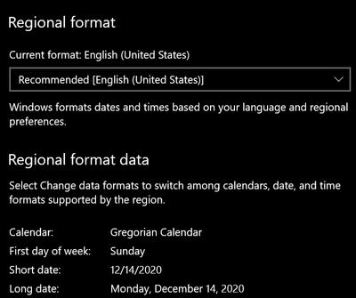

And what are your computer date settings?

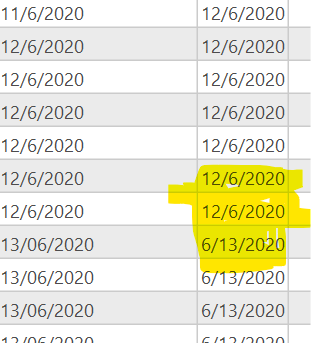

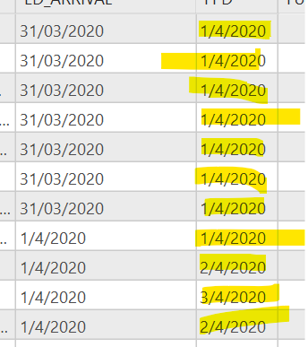

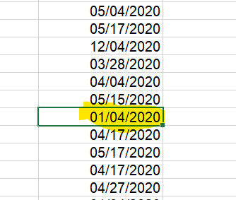

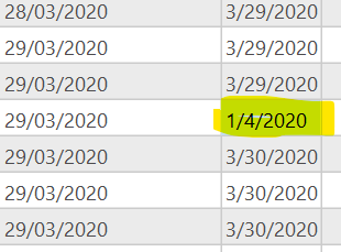

Basically i am doing hotspot analysis, I am an emergency physician,new to arcgis pro,learning from you people,And my date may not be continuous,and it is some within date field,all are first 12 days of month,i tried changing date format in excel by exporting again,but the specific dates are not changing in excel also.date format computerdate format computerarcgis pro datearcgis pro datearcgis pro datearcgis pro dateall dates till 13th and after mm/dd/yyyyall dates till 13th and after mm/dd/yyyydate from excel.png ,i have attached the screen grabs
