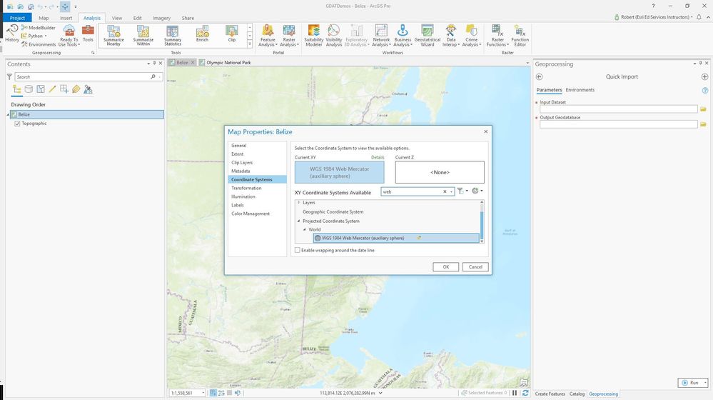

One thing I would try is close ArcGIS Pro and reload your project file.  When you share the Web Map to your Portal, I'd recommend changing the Map View Coordinate System to WGS 1084 Web Mercator (auxiliary sphere) to publish the web map.  Does the issue persist? Please advise.

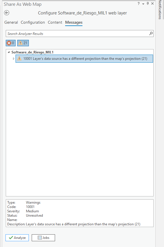

FlorenciaPineiro
Hi Robert,
Thanks for your answer. I've followed your indications but I couldn't solve the problem.

Interesting.  Right-click on the warning message and it should direct you how to resolve this issue.  Still researching why the Share button is not present.

I see what's happening.  You're "stuck" in the configuration window.  Click the left facing arrow towards the upper left of the window underneath the words "Share as Web Map" to return to the main tool process window.  Then you will see Analyze, Share, and Jobs.
FlorenciaPineiro
Robert,
I really appreciate your help. It works!! Thank you very much. I'd been leading with this issue for a few days.
