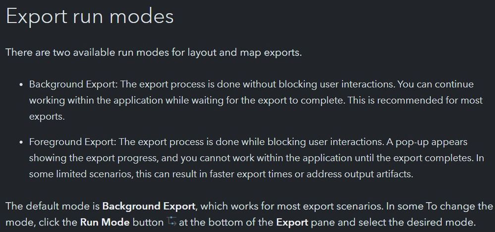

TomBole
Hi @jmaxwell_braun
"Cloning" the map/layout allows the export to run in the background. Without the export running in the background you wouldn't be able to interact with Pro at all during the export time. Usually, copying the data is a fast process and isn't noticed, but in some instances it can take longer.
If you don't want to run your export in the background, you can do it via Python. The export methods and samples can be found here https://pro.arcgis.com/en/pro-app/latest/arcpy/mapping/layout-class.htm. If you export via the python window the data won't be copied, so your export should be faster. However, you won't be able to use ArcGIS Pro while the export is going on.
With version 3.7 we introduced export run modes. The python work-around mentioned above is basically the same as the foreground mode described here.
I know that you are working with 3.6, and the python work around should work with 3.6, but I thought you might be interested in this new option if you upgrade.
Hope this helps,
