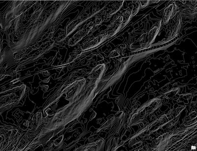

I have a DTM with resolution in 0.25m. I use it to calculate the slope, but results seems like elevation curves, Anyone know the reason? Resample to 1m and change the symbology didn't help.
Bests,
Fiona
Fiona
I think I might be know where are the problem, the first one is after "Mosiac to new raster", the second is the original tif file. Probably the parameter in function I used were wrong.

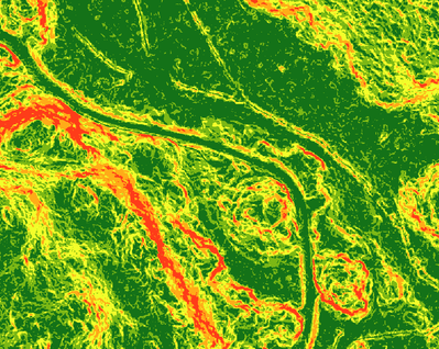

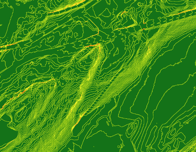

a screen grab of the issue you are experiencing might be helpful to provide further comment
... sort of retired...
Fiona
Value from 90-0 degree.
Fiona
