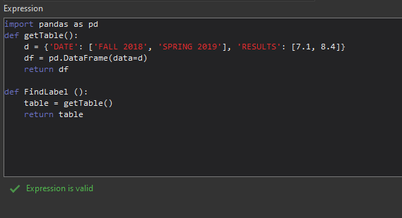

I want to create simple tables in my labels. I thought that using python and pandas dataframe might work, but although the expression verifies as valid, no labels appear on my map. Is there a different way to accomplish this either in Python or a different language? I am using ArcPro 3.1. Thanks

Labels only show strings, s you have to return a string.
I can' test right now, maybe it works with the DataFrame method:
def FindLabel():
    table = getTable()
    return table.to_string()
If it doesn't, you can try constructing it yourself (untested):

EmmaO
table.to_string() works! Thank you

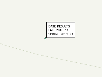

Can you post a screenshot for how the final product looks? I tried in arcgis pro 2.9.0 but its just text separated by spaces. Thanks.
EmmaO
Here is what it looks like in 3.1. I actually spoke a little too soon. I thought that using the methods here I would be able to format it how I wanted, but having played around, I haven't been able to do so. It also would be nice if there were lines to format the table, but I'm not sure if that's possible.
