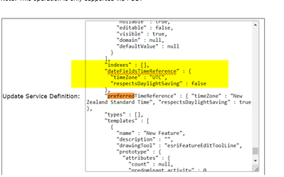

Hi @ChristopherCounsell , Thanks for sharing this link. I've tried in one of my tracker views created for testing. It didn't change the time yet. Should I also be switching the lines highlighted above in this screenshot? With just a little more guidance I think I can get there.

No - I would not recommend changing the service definition.
https://doc.arcgis.com/en/arcgis-online/reference/use-tracks.htm
All datetime values are recorded in coordinated universal time (UTC).
UTC in Esri is a thing for a reason. Some editor tracking lets you specify the time zone. Back in 2020 it wasn't an option for Tracker. Doesn't look like you can do it now.
I would recommend accommodating the desired location offset in your FME Server workflow.
Esri will do it real time from UTC to the device. FME can do it by adding 10 hours to your desired output...
