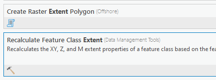

I have a custom toolbox (.tbx) added to my favourites and so to find a specific tool within the toolbox, I 'd search (Tools > Favorites > [Type tool name] and then hopefully see the description of the tool in the results display but doesn't seem to display the metadata. Let's say I have a tool called 'Create Raster Extent Polygon' and I enter 'extent' in the search to get the result I need. It doesn't seem to display the tool description even though I have added information in all of the fields in the metadata page of the custom tool. Is there a way to show the tool description for custom tools similar to the inbuilt Esri ones? (See image for the custom tool example and the Esri tool that shows a nice tool description).

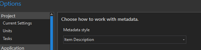

I use the default metadata option, which seems to be "Item description".

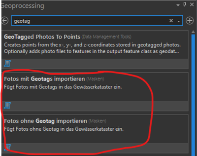

Like you, I just tried creating a new python toolbox, editing the metadata of the default tool and searching for that tool. Didn't work:
Then I remembered: For my work, I programmed quite a few tools (e.g. input forms). Because the tools were in constant development, I didn't want to manually edit the metadata each time I changed some parameters. So I created a custom Parameter class and gave the Tool class some extra attributes and wrote a function that creates the tool help files automatically.

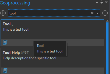

And it works:
Please don't ask me why...
