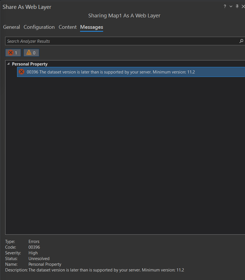

ArcGIS Pro 3.3 is compatible with ArcGIS Enterprise 11.0 and above. Why will the program not register what version of Enterprise or default to the current Enterprise version?  I have notice that this is becoming an issue with Pro 3.3. I have ran similar issues with arcade labeling and attribute rules, however, Barbara S. (ESRI) has been able to help me with solutions. Are there any work-a-rounds for sharing web layers?
2 Solutions
RyanUthoff
MVP Regular Contributor
The problem technically isn't with ArcGIS Pro. The problem is with your underlying data. Esri released new GDB functionality at 3.2. Some of which include new high precision date fields and 64 bit ObjectIDs. So if you created new tables at 3.2+, then often times by default, it will include this new GDB functionality which is not compatible with versions of ArcGIS Enterprise 11.1 or earlier.
Unfortunately, there isn't really a solution except to not use this new functionality.

Okay, thank you for your rapid response. This is valuable information. This particular data is derived from an 10.2 GDB (Yes, I have tried to address how old this GDB is.). I have had similar questions about some internal issues we are experiencing. I think this link you shared will help with those as well.
