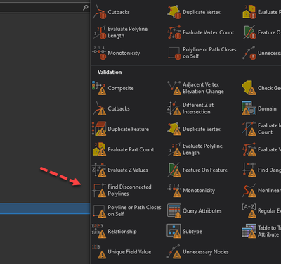

JoseG_Esri
you could use "Find Disconnected Polylines" in the Attribute Rules > Ready to use Rules
