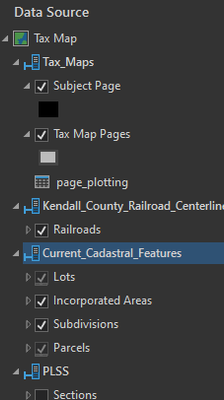

I don't know that you can, but it would be helpful to know more about the source data.
When you copy the data, it's creating brand new tables and services in your portal's internally-managed data store, so it's not as important where the published layers come from in that instance.
When you publish the layers and keep them referenced, it matters more what the source looks like. If they're coming out of separate SDE connections, there's no way for Server to treat them as members of a single group. You can click over to the Data Source tab in your map to see where they're coming from.

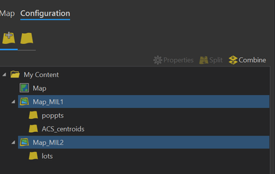

Anything in a file-based data source is going to be copied to the server machine and accessed differently from something in an SDE. I don't think there's a way to "control" it, other than just organize all the data prior to publishing, but what do you see on the Configuration tab when you're getting ready to share the web map? If you select the to-be-published map image layers, are you able to click Combine?

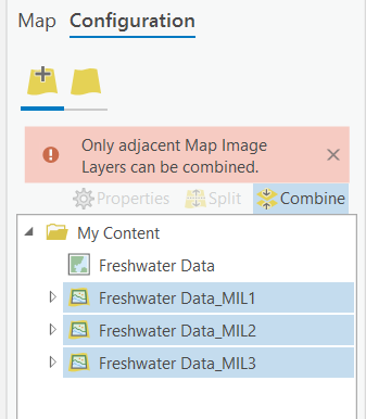

I tried the combine and it gives me the error below.
All the data is coming from about 5 different data sources and some of the layers that are split across the 3 map image layers are all from the same file geodatabase. The path is the same and I have no versioning.

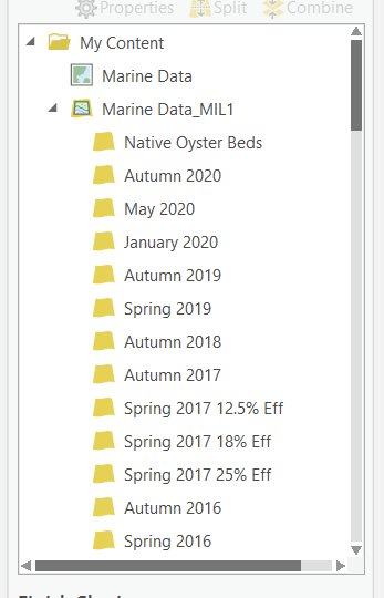

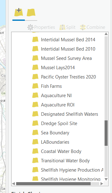

The web map with 70 layers isn't publically accessible data so I can't share but from the scrollbar on the screenshots below you'll see there are a lot of layers. Now many of these are from the same datasets but there are about 10 different file locations for the file and sql geodatabases, that double my other viewer and it has no problems storing them all in the same map image layer!

Here's the relevant section of the docs. We don't publish web maps this way where I work, so I'm a bit out of my depth here, but I noticed the line
"In most configurations, web layers must be adjacent to be combined. This requirement does not apply to the Copy all data: Exploratory or Copy all data: Editable configurations."
Perhaps those settings for the 70-layer map were different from the current one? Note that to change those settings it's referencing, you have to click Properties for each Map Image Layer in the list.
