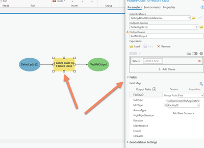

However, since you are not familiar with python, for this operation, you might want to look at creating a Model.
All you would need to do is add Feature Class To Feature Class tool and configure the Fields section to only include what you want.  Save the model, then all you need to do is edit the model, double click on the FC 2 FC tool, change output location and hit "Run".

could also make a model and save it so you only have to set it up once.
