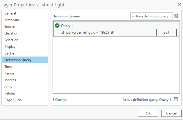

And here is a screenshot showing the contents when I open the query definition properties:
Again, the def query gets added, but doesn't actually get applied until I open the properties and hit OK without making any changes.

Thanks for the suggestion. Unfortunately a map refresh does not activate the definition query. It seems they can only be activated by opening the layer properties, clicking on the definition query, and then clicking OK.
